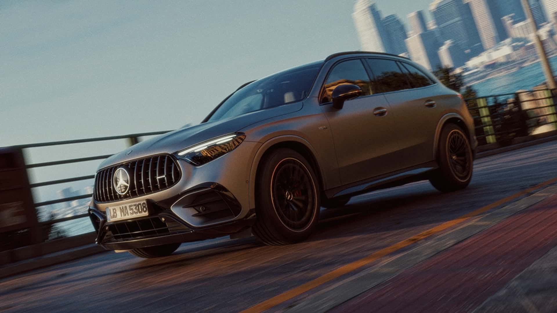

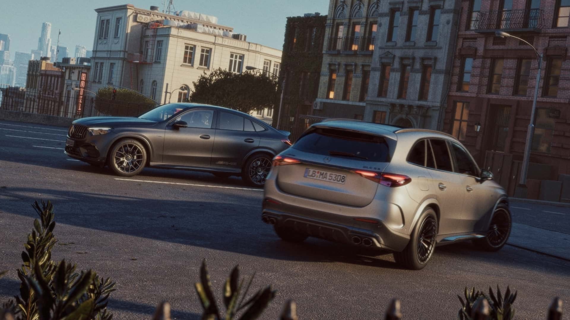

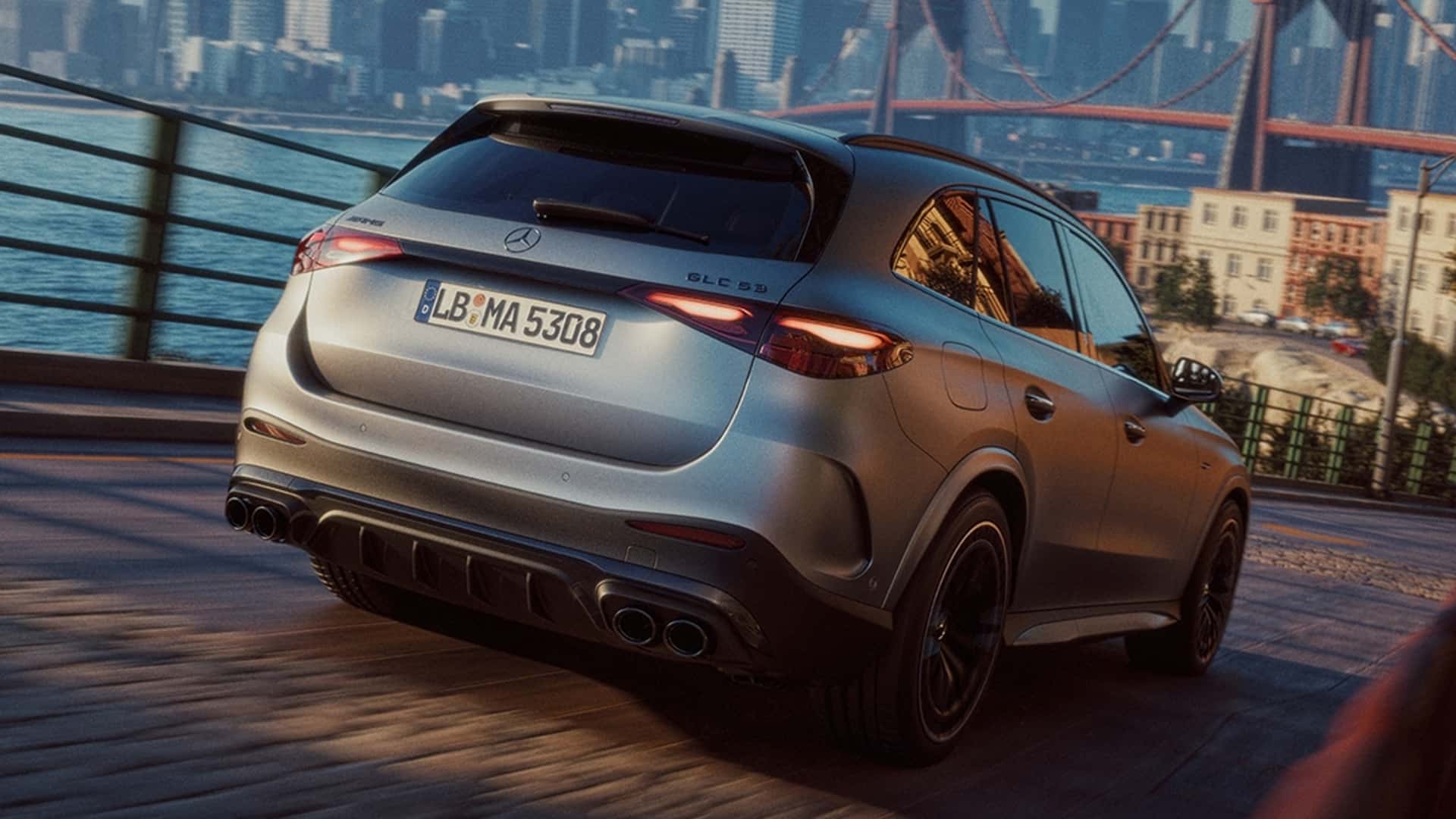

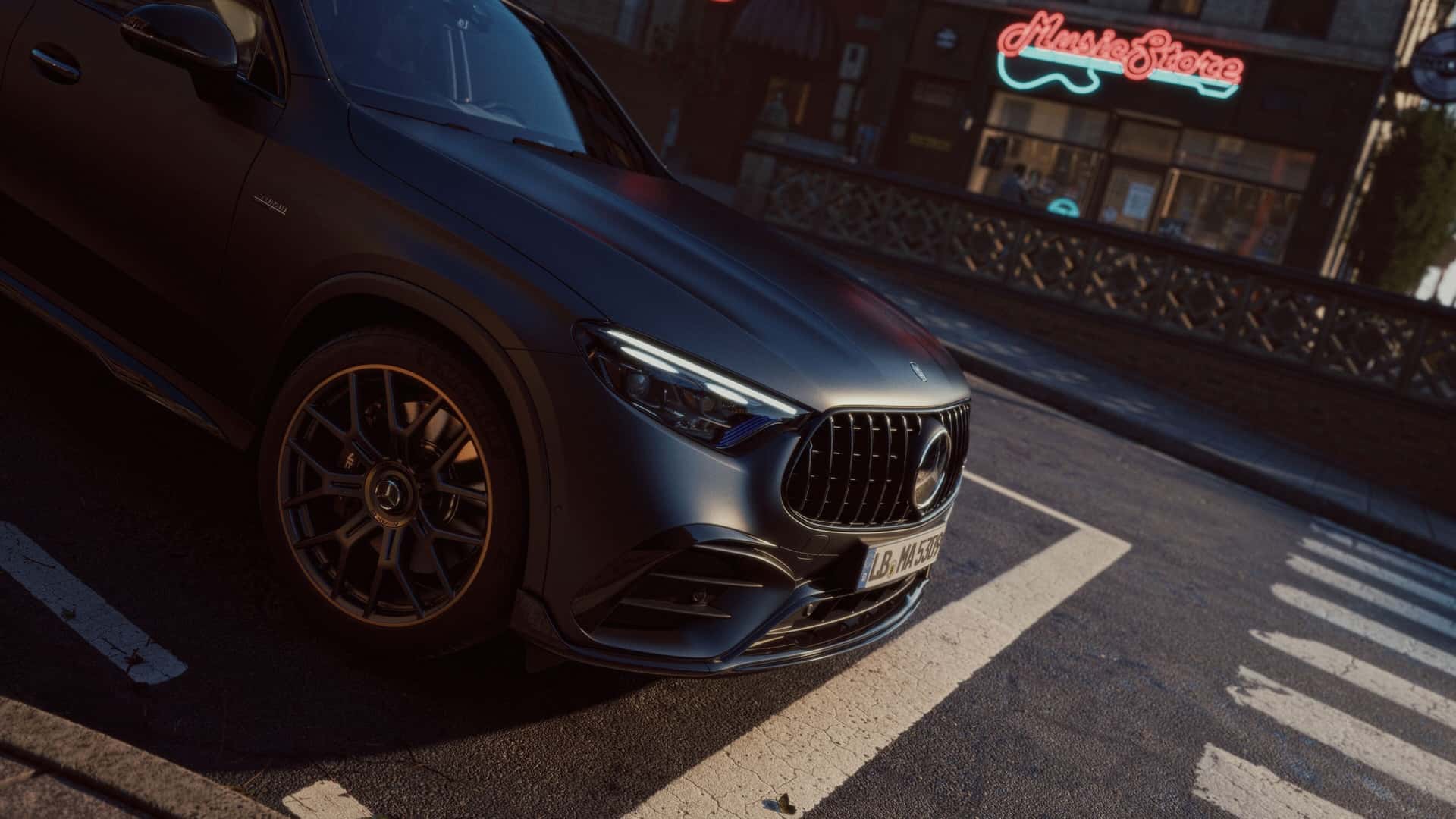

Presentados los 43 y 63 AMG.
El 43 AMG lleva un motor turboalimentado de 2.0 litros 421 cv, cuenta con una transmisión de embrague múltiple de nueve velocidades y tracción total 4Matic
El 63 SE Performance tiene un motor turbocargado de cuatro cilindros y 2.0 litros que funciona con un motor eléctrico montado en la parte trasera para producir 680 cv y 752 Nm. la transmisión es de embrague múltiple de nueve velocidades y tracción total 4Matic.
63 AMG.
43 AMG.

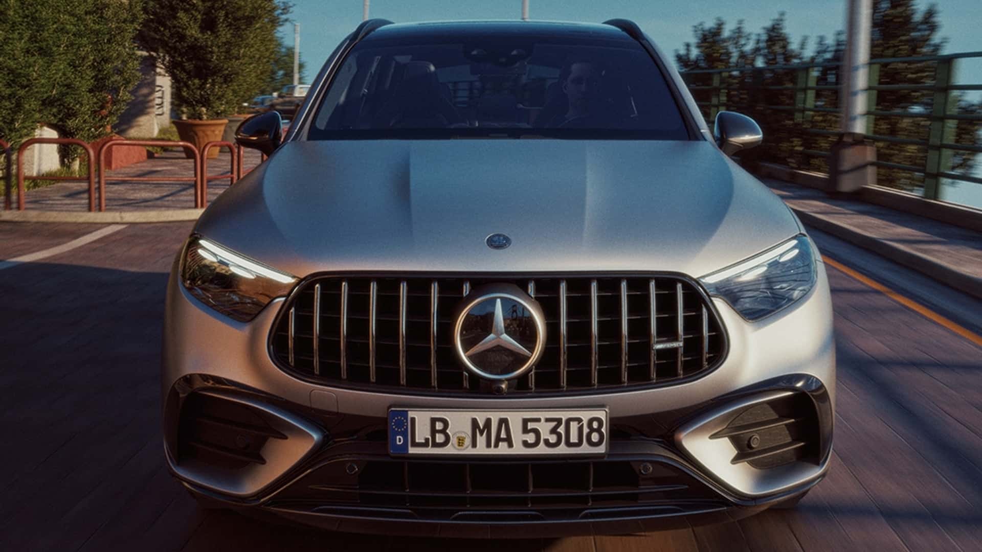

Characteristic AMG elements for the exterior and interior ensure a sporty, refined appearance
On the outside and inside, numerous AMG-specific details underscore the dynamic and high-quality character of the new Mercedes-AMG GLC variants in equal measure. In the exterior design, these include the AMG‑specific radiator grille with vertical struts and the AMG front apron with flics, sporty air intakes and chrome-plated trim element. Flics, large inlets and air curtains direct the airflow specifically to the various functions. Harmoniously integrated side sill panels, the diffuser-look rear apron (GLC 43) or additional diffuser board (GLC 63 S) and the two twin tailpipe trims (round on the GLC 43, trapezoidal on the GLC 63 S) round off the design.

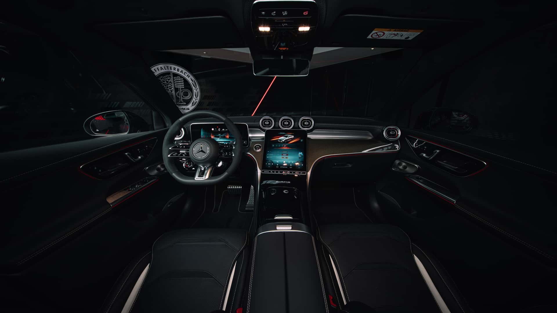

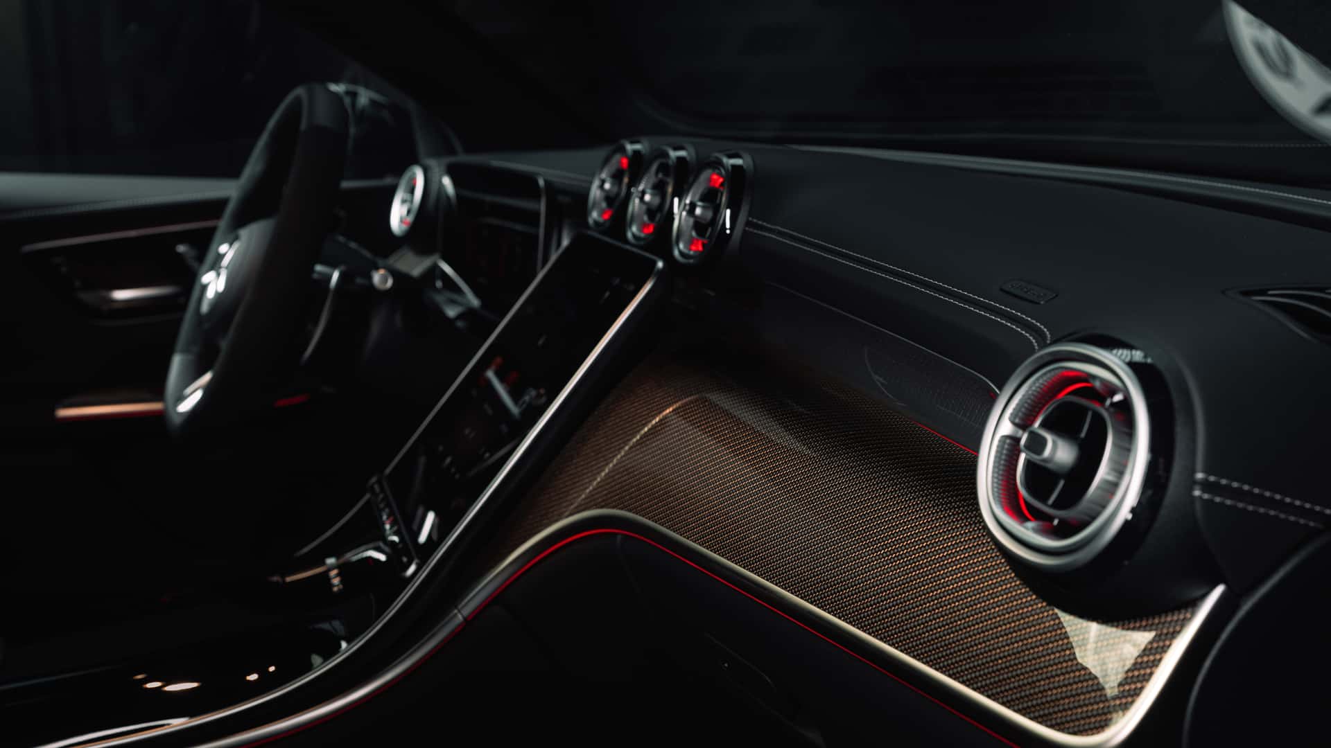

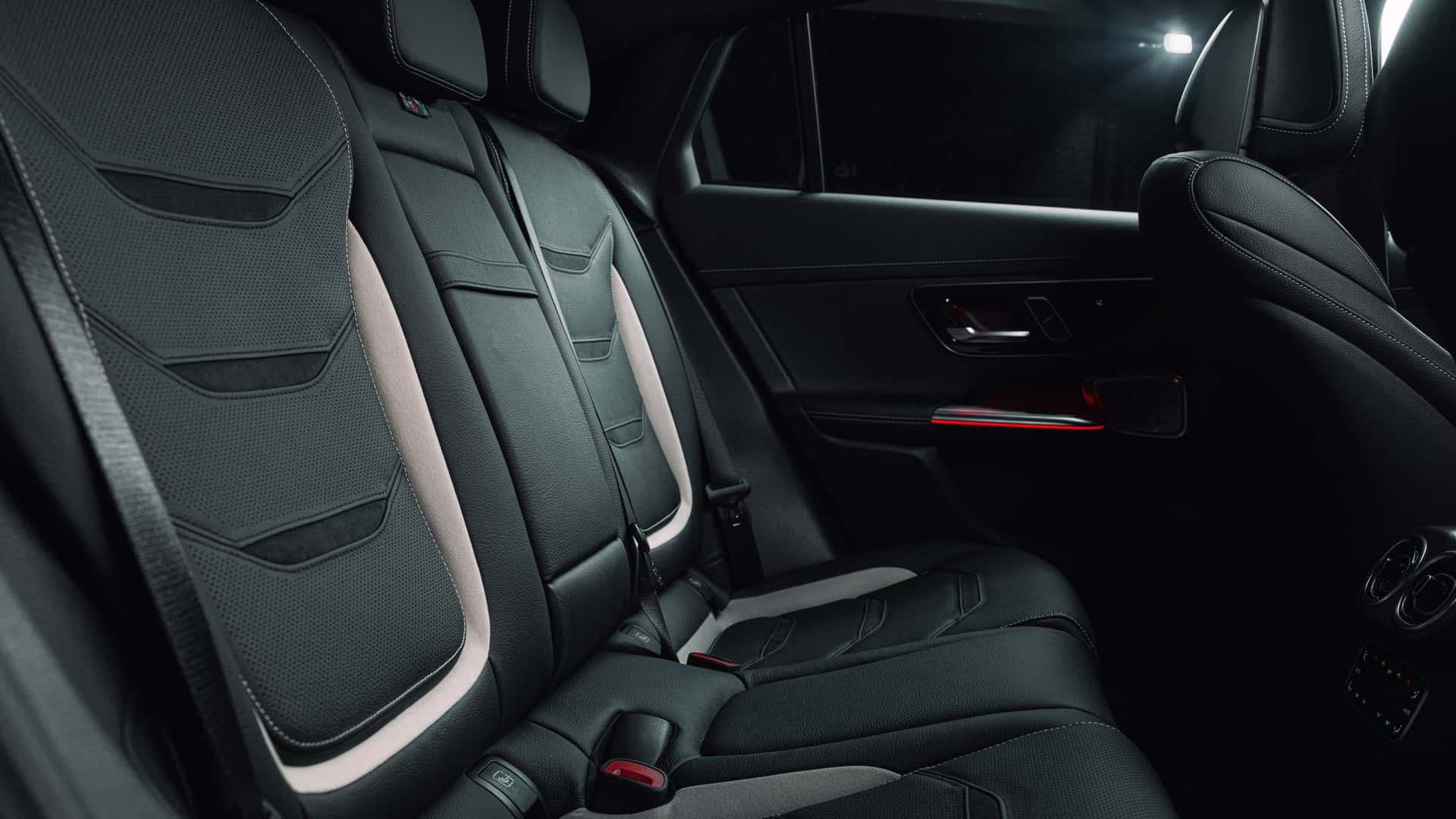

In the interior, AMG seats in ARTICO man-made leather/MICROCUT AMG microfibre with distinctive graphics and upholstery add a sporty touch. Optional leather and nappa leather upholstery with embossed AMG crest in the front head restraints is available. The AMG Performance seats are also available as an option.
The AMG Performance steering wheel in nappa leather (GLC 43) or nappa leather/MICROCUT microfibre (GLC 63 S) is also fitted as standard. It is flattened at the bottom, perforated in the grip area and equipped with silver-coloured aluminium gearshift paddles. The two round AMG steering wheel buttons allow fast and unerring operation of various dynamic driving functions and of the AMG DYNAMIC SELECT drive programs. The sporty-luxurious atmosphere is rounded off by AMG sports pedals, AMG floor mats and illuminated door sill panels with AMG lettering.
The MBUX infotainment system includes various AMG-specific displays and functions. These include special displays in the instrument cluster, on the portrait-orientation multimedia central display in the centre console and on the optional head-up display. The AMG exclusive «Supersport» style offers the option of displaying various contents via a vertical structure. This includes a set-up menu that displays the current settings of the suspension or transmission. In addition, the driver can have a navigation map or consumption data displayed in “Supersport» style.
Also integrated is AMG TRACK PACE (standard in the GLC 63 S, optional for the GLC 43), the data logger for use on the racetrack. The software records more than 80 vehicle-specific data such as speed, acceleration and steering angle ten times per second while driving around a race track. Also informative are the display of lap and sector times as well as additional training and analysis tools.

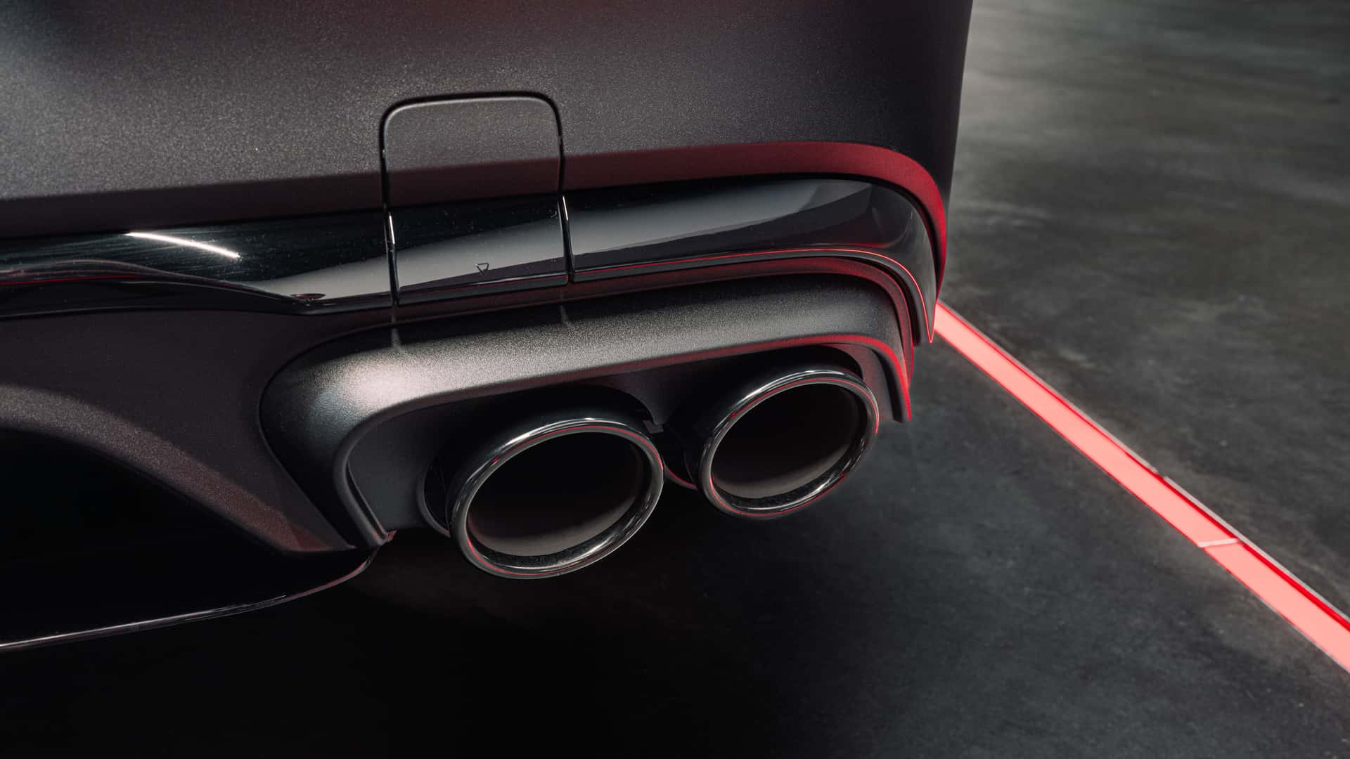

AMG sports braking system and AMG exhaust system with sporty engine sound
The AMG sports brake system in the GLC 43 guarantees outstanding deceleration values and optimum control. Internally ventilated and perforated brake discs measuring 370 x 36 millimetres with 4-piston fixed callipers are fitted to the front axle and 360 x 26 millimetres with 1-piston floating callipers to the rear.
In keeping with the extreme power values and the associated performance, the AMG high-performance composite brake system with 6-piston fixed callipers at the front (internally ventilated and perforated brake discs 390 x 36 mm) and 1-piston floating callipers at the rear (internally ventilated and perforated brake discs 370 x 26 mm) comes as standard on the GLC 63 S. The brake system impresses with very short braking distances as well as maximum stability and fade-resistance under heavy use. In addition, it scores with a long service life and a particularly fast response.

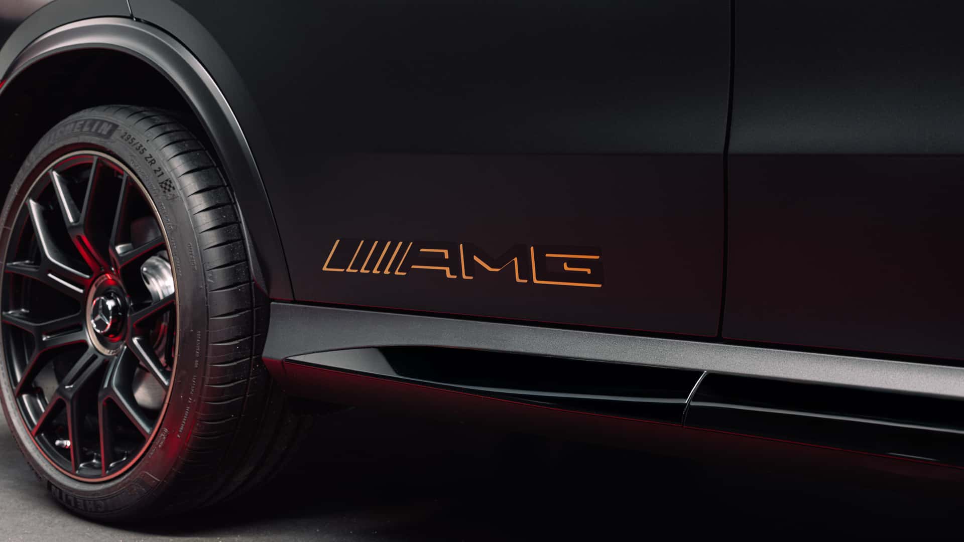

The AMG Exterior Night Package includes the painted exterior mirror housings in high-gloss black, the inlays in the AMG side sill trims, the shoulderline trim strip, the window surrounds and the trim strip in the rear bumper. Added to this are heat-insulating dark-tinted glass from the B-pillar and the two black chrome-plated twin tailpipe trims of the AMG exhaust system.
With the AMG Night Package Exterior II, dark chrome is added: the fins of the radiator grille in dark chrome as well as the model badges on the wings and on the rear, including the star at the rear.
The AMG Carbon Exterior Package includes elements in high-quality visible carbon for the A-wing of the AMG front apron, the inserts of the AMG side sill panels and the trim strip in the AMG rear apron. The AMG Styling Package makes the GLC 43 look even sportier: The front splitter in high-gloss black with flics on the sides and the rear diffuser with diffuser board are visual borrowings from motorsport. Furthermore, there are additional flics for the air outlets in the rear apron in high-gloss black.

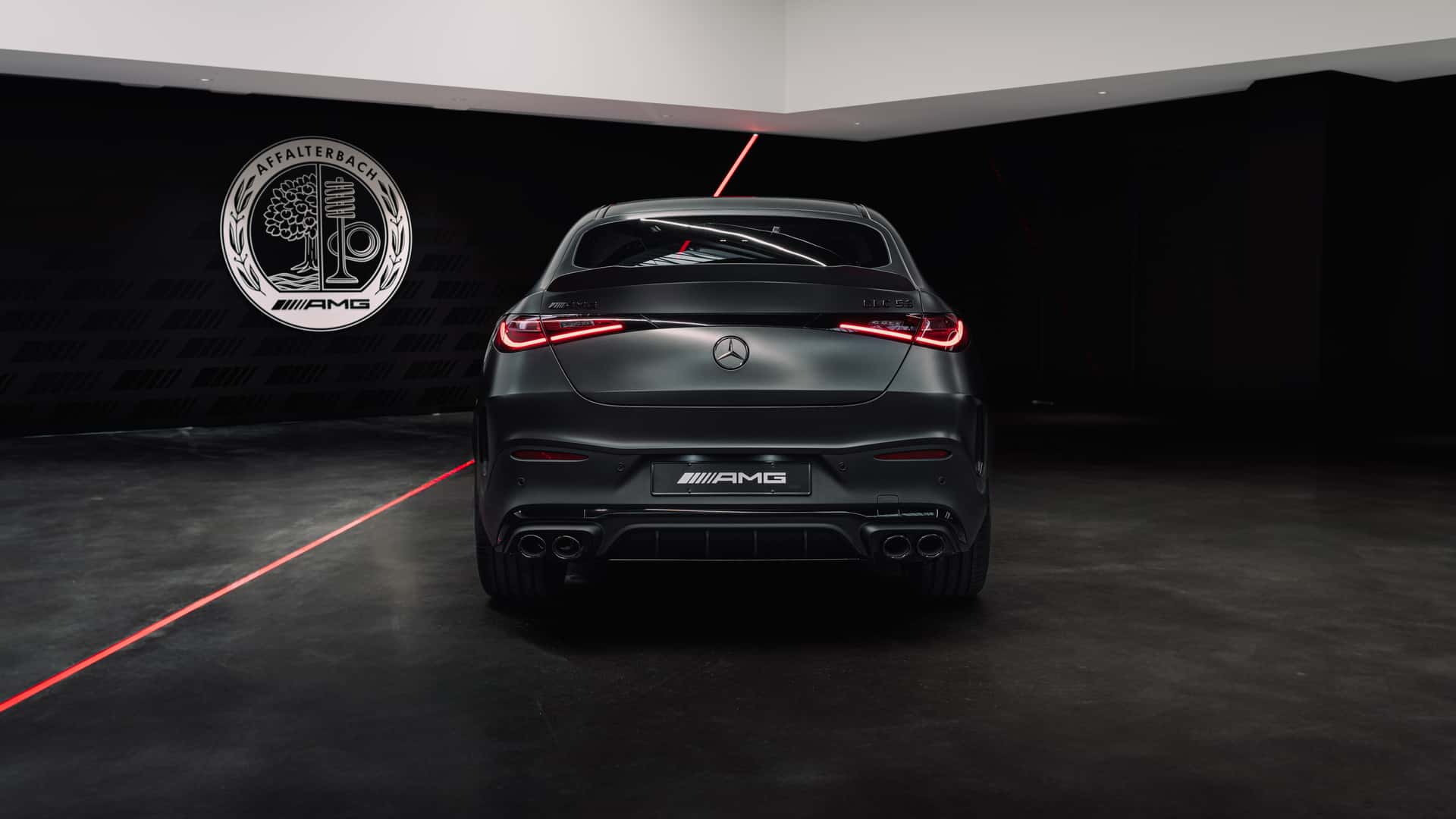

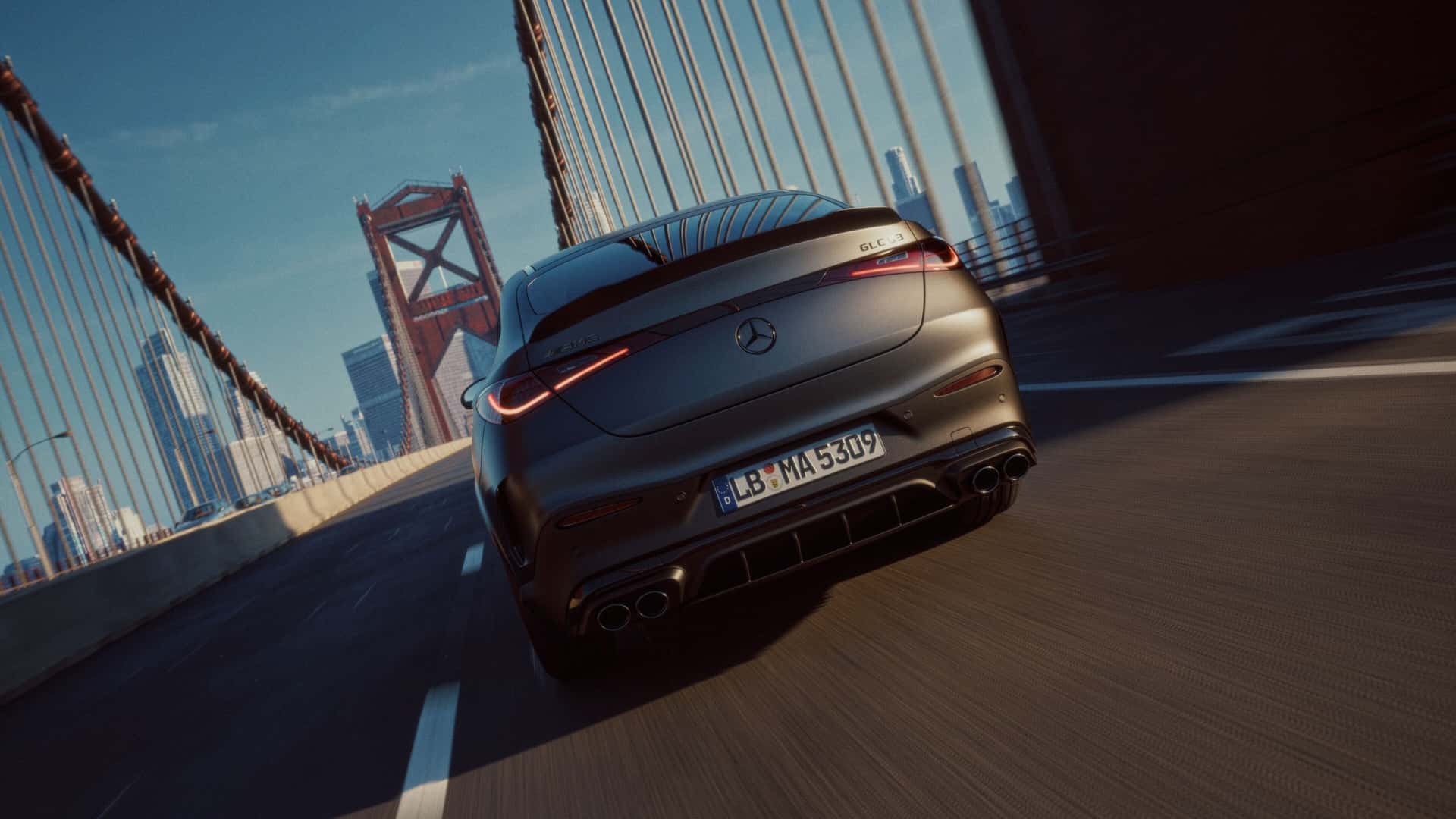

Presentados los 43 y 63 AMG Coupe.
Fuente: Mercedes-AMG

A few weeks after the presentation of the new Mercedes-AMG GLC SUV, the performance and sports car brand is presenting the new GLC Coupé. It completes the successful midsize series from Mercedes-AMG and sets another highlight in the model portfolio with its combination of dynamic elegance and characteristic AMG features. Striking proportions and exciting surfaces underline its unmistakable appearance, complemented by the high-quality interior.
There are two powerful model variants to choose from: The GLC 63 S E PERFORMANCE Coupé is the brand’s first performance hybrid SUV coupé (combined fuel consumption: 7.5 l/100 km, combined CO₂ emissions: 170 g/km, combined power consumption: 12.7 kWh /100 km)[1] with 500 kW (680 HP) system output at the start. There is also the entry-level model, the GLC 43 4MATIC Coupé (combined fuel consumption: 10.2-9.8 l/100 km, combined CO₂ emissions: 232-223 g/km)1 with 310 kW (421 hp) power and a short-term boost of 10 kW (14 hp) via the belt-driven starter generator (RSG). The extensive standard equipment with rear-axle steering, all-wheel drive, AMG SPEEDSHIFT MCT 9G transmission with wet starting clutch and AMG RIDE CONTROL suspension with adaptive damping supports the dynamic driving experience.
“With the new Mercedes-AMG GLC Coupé, we are addressing customers who are looking for a sporty lifestyle and dynamic design coupled with impressive performance. The diverse and high-quality technical components guarantee the highest level of driving dynamics and pleasure. With the top model GLC 63 S E PERFORMANCE Coupé, we now also offer our innovative hybrid drive in this segment, which guarantees an extensive range of driving experience.»
Michael Schiebe, CEO Mercedes-AMG GmbH and head of business units Mercedes-Benz G-Class & Mercedes-MaybachThe sporty silhouette with a flowing transition to the rear is the main feature of the new Mercedes‑AMG GLC Coupé. The headlights connect to the top of the AMG-specific radiator trim and thus emphasise the width of the vehicle. The AMG front apron in jet wing design with large air inlets, vertical fins and additional flics sets striking, independent accents. Precise side edges emphasise the sporty proportions and the powerful wheel arches.
The wheel arch trim in the body colour and the AMG side skirt trim are harmoniously integrated into the elegant basic shape. The confident appearance is also emphasised by the wide track and flush-fitting wheels in 19-, 20- or 21-inch formats. Several of the wheels offered ex works feature a glossy aesthetic with bi‑colour surfaces. Optional equipment includes entry-optimised running boards and numerous other packages.
The two-part taillights visually widen the rear view with a black, dark red connecting element. The AMG‑specific rear apron in a diffuser look (GLC 43) or with an additional diffuser board (GLC 63 S) as well as the two double tailpipe trims (round on the GLC 43, trapezoidal on the GLC 63 S) reinforce the powerful impression.

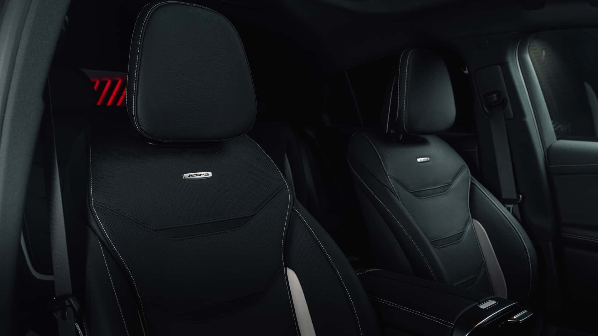

In the interior, AMG seats in ARTICO man-made leather / MICROCUT AMG microfiber with unique graphics and covers provide a sporty touch. Optional upholstery made of leather and Nappa leather with an embossed AMG coat of arms in the front headrests is available. The AMG performance seats are also available as options.

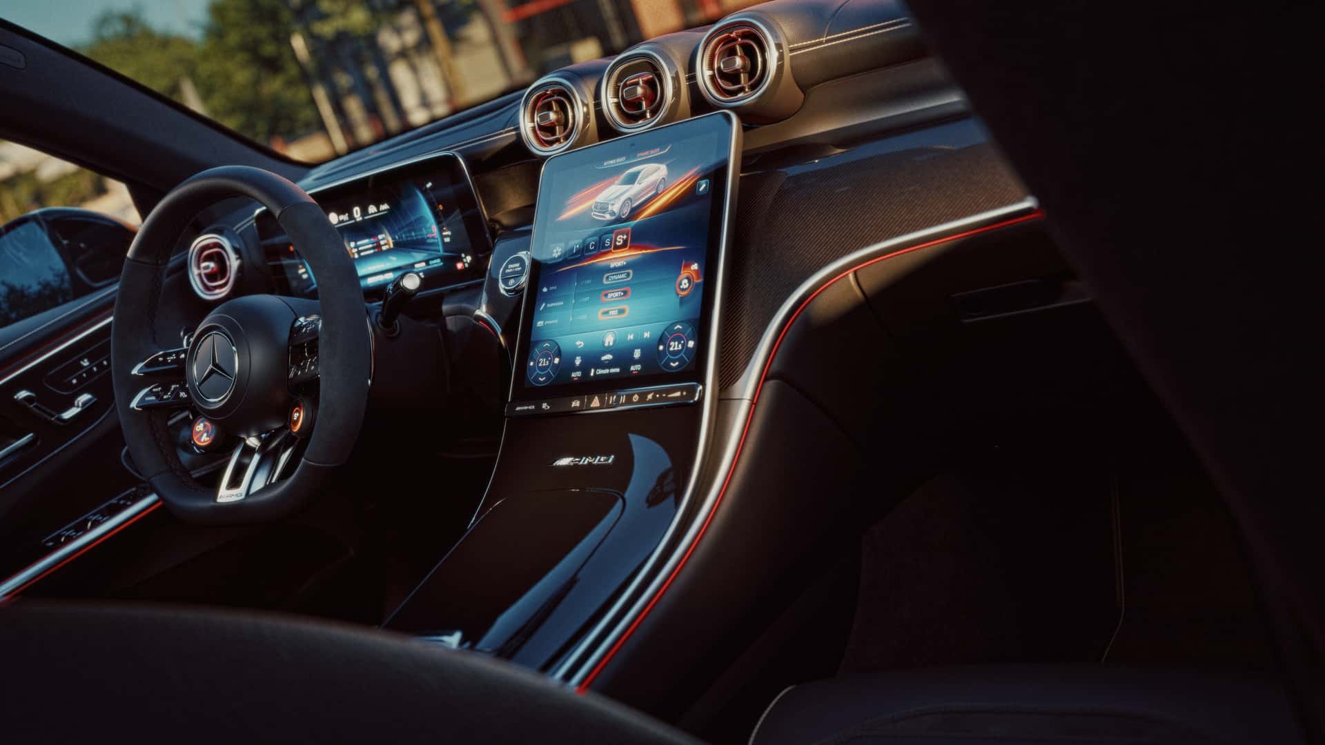

There is also the standard AMG Performance steering wheel in Nappa leather (GLC 43) or Nappa leather/MICROCUT microfiber (GLC 63 S). It is flattened at the bottom, perforated in the handle area and equipped with silver-coloured aluminum shift paddles. The two round AMG steering wheel buttons enable quick and precise operation of various driving dynamics functions and the AMG DYNAMIC SELECT driving programmes. The sporty, luxurious atmosphere is rounded off by AMG sports pedals, AMG floor mats and illuminated door sills with AMG lettering.
The MBUX infotainment system includes various AMG-specific displays and functions. These include the independent displays in the instrument cluster, in the portrait format multimedia central display in the centre console and in the optional head-up display. The AMG exclusive “Supersport” style offers the possibility of displaying various content via a vertical structure. This includes a set-up menu that shows the current chassis or transmission settings. The driver can also have a navigation map or consumption data displayed in “Supersport” style.
Also integrated is AMG TRACK PACE (standard in the GLC 63 S, optional for the GLC 43), the data logger for use on the racetrack. The software records more than 80 vehicle-specific data ten times per second while driving around a racetrack, such as speed, acceleration, steering angle and brake pedal operation. The display of lap and sector times as well as additional training and analysis tools are also revealing.

Presentado el 53 AMG
Incorpora el motor 3.o Turbo de 6 cilindros que genera 449 CV y 587 Nm de par. El 0 a 100 km/h lo realiza en 4,1 segundos y alcanzan una velocidad máxima de 270 km/h con el Paquete AMG Dynamic Plus.
Es el primer crossover de Mercedes en incorporar el modo Drift para realizar derrapes.
