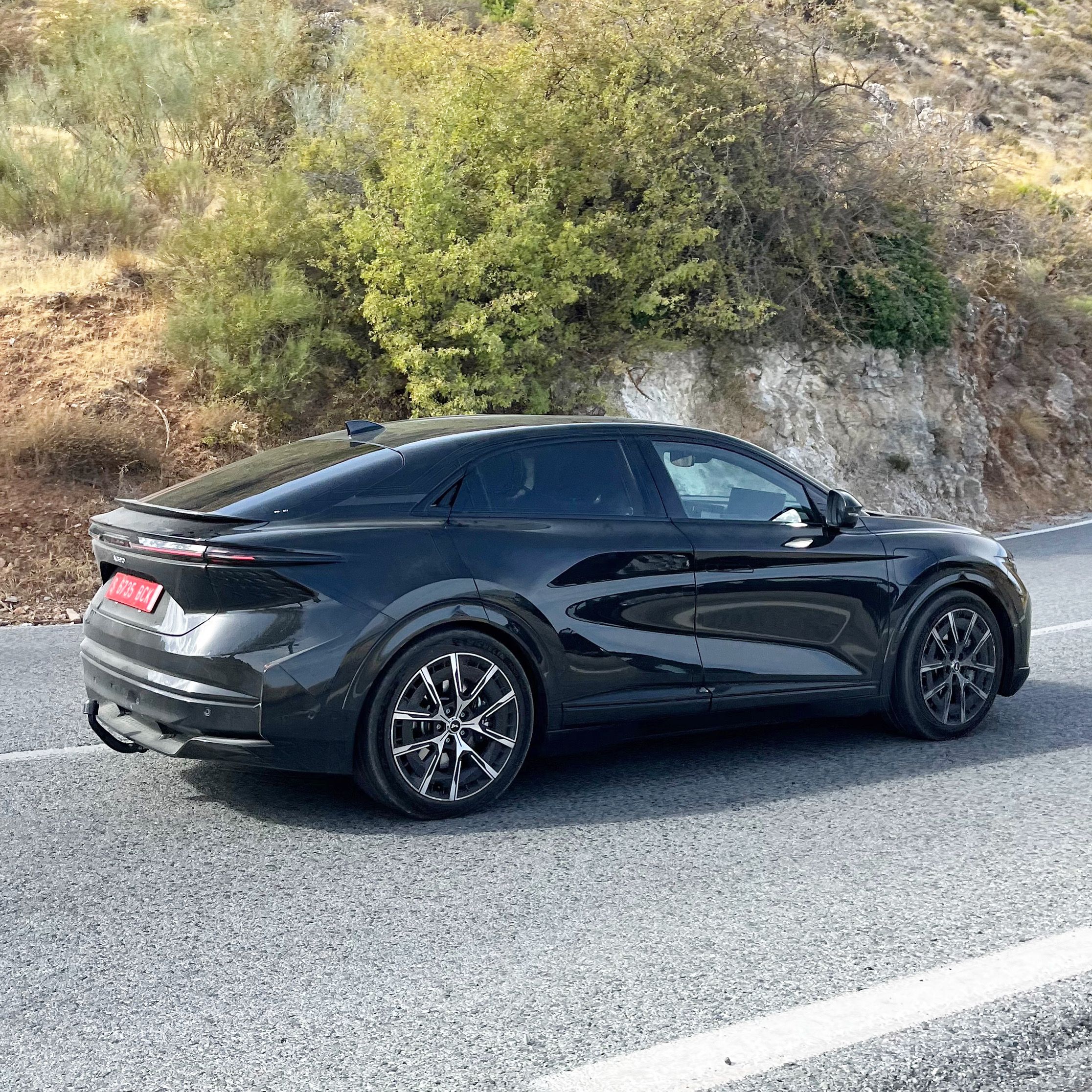

                    Fotos de Le Nouvel Automobiliste, via worldscoop
                    Avatar de Sombrilla500
                      9877EE78-6B2B-4C24-BBCB-8A4409BA1BE0A0EB4CC3-BDE1-48BD-9C99-30416D42FFE0
