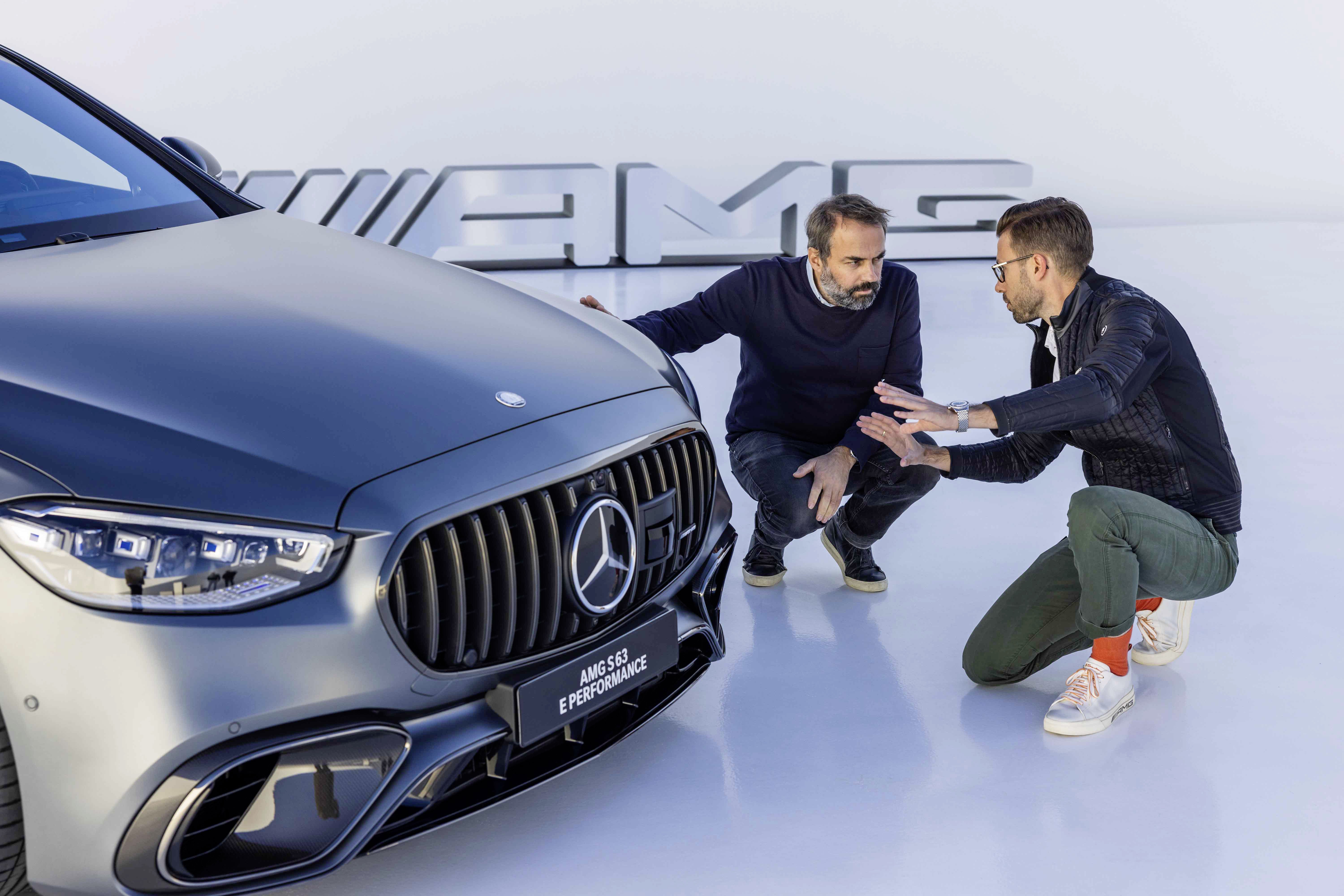

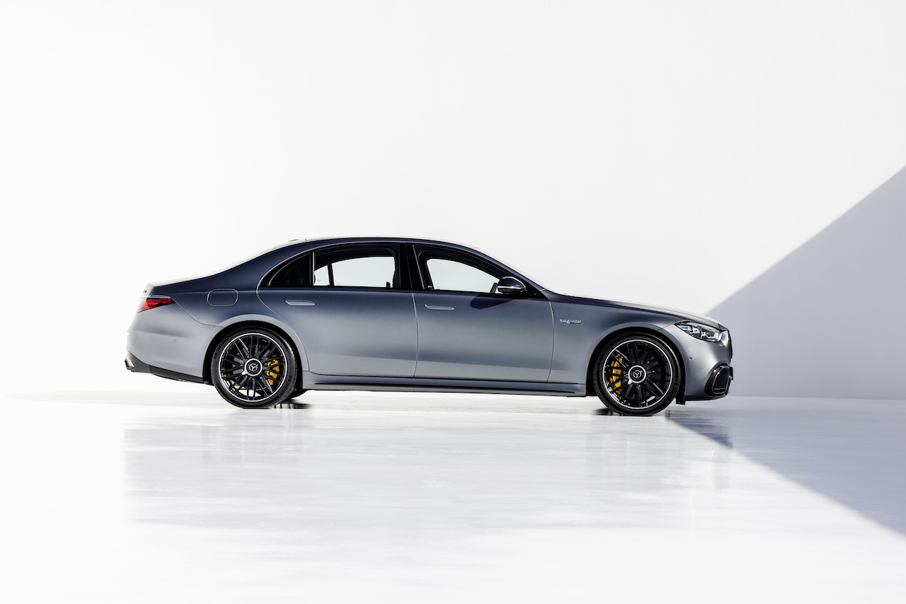

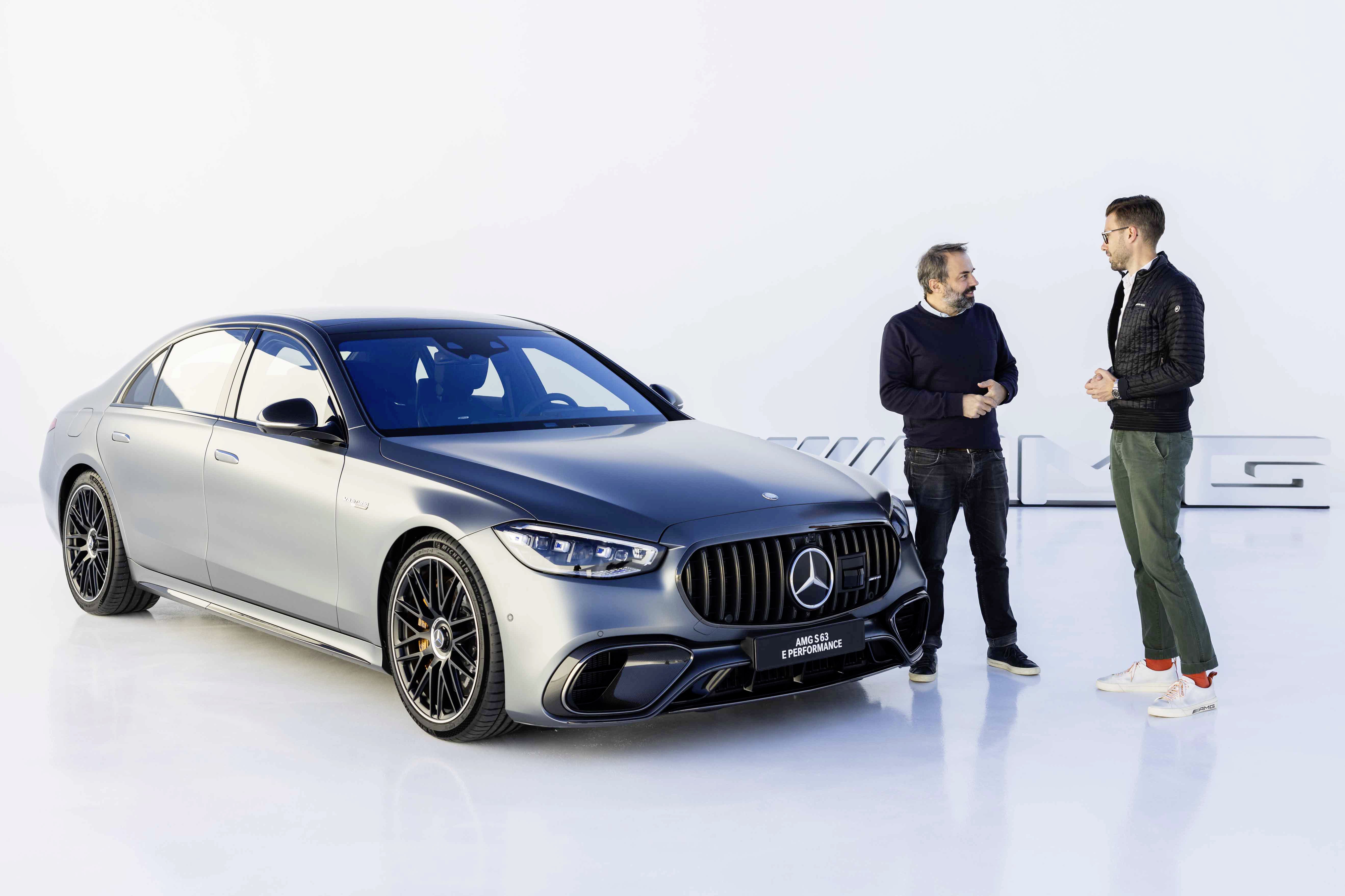

                              Presentado el AMG S63 super-PHEV

                                      • AMG-specific radiator grille in the performance luxury saloon for the first time

                                      Expressive exterior design
                                      The impressive performance of the Mercedes-AMG S 63 E PERFORMANCE is also suggested by the expressive exterior design. For the first time, an S-Class Saloon bears the AMG-specific radiator grille with vertical louvres and a large central star. The previous Mercedes star on the radiator has been replaced by the AMG emblem in silver chrome/black. In addition, the front apron in jet-wing design with large side air inlets and functional air curtains characterises the front view. In the side view, the up to 21-inch AMG forged wheels and the AMG-specific side sill panels particularly stand out. At the rear, there are characteristic design features of the ’63 models such as the trapezoidal, fluted twin tailpipes or the wide diffuser with longitudinal fins and diffuser board.

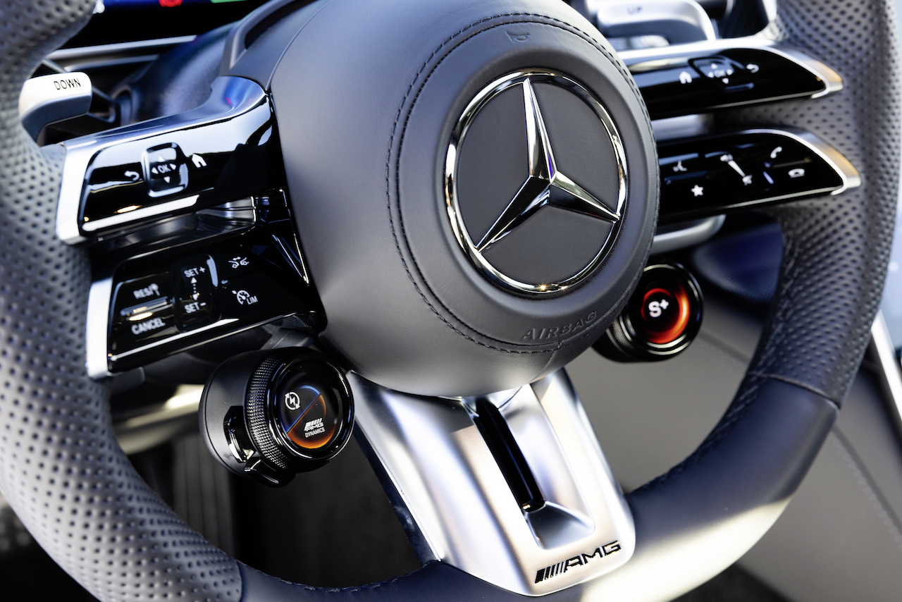

                                      AMG Performance steering wheel in twin-spoke design
                                      The AMG Performance steering wheel with its distinctive twin-spoke design and seamlessly integrated gearshift buttons also contributes to the hallmark AMG look. The AMG steering wheel buttons impress with their brilliant displays and intuitive operating logic. They allow important driving functions and all driving modes to be controlled without the driver’s hands leaving the steering wheel. The recuperation levels of the hybrid drive can also be selected via the steering wheel buttons.
