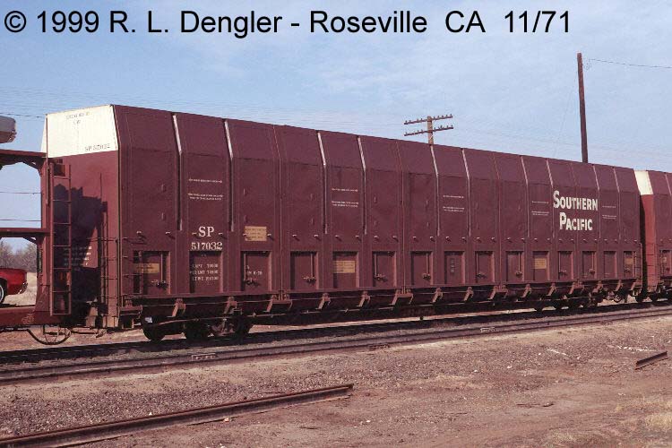

el Transporte
Vert-A-Pac
The Vega was designed to be shipped vertically, nose down. Special rail cars known as Vert-A-Pac cars designed jointly between General Motors and Southern Pacific and held 30 Vegas versus 18 in normal tri-level autoracks. Each Vega was fitted with four removable, cast-steel sockets inserted into the undercarriage.[91]Vegas loaded on Vert-a-pac Chevrolet conducted vibration and low-speed crash tests to make sure nose-down Vegas wouldn’t shift or be damaged in railcar collisions. Chevrolet’s goal was to deliver Vegas topped with fluids and ready to drive to the dealership. To do this Vega engineers had to design a special engine oil baffle to prevent oil from entering the No. 1 cylinder, batteries had filler caps located high up on the rear edge of the case to prevent acid spilling, the carburetor float bowl had a special tube that drained gasoline into the vapor canister during shipment, and the windshield washer bottle stood at a 45 degree angle. Plastic spacers were wedged in beside the powertrain to prevent damage to engine and transmission mounts. The wedges were removed when cars were unloaded. The rail car doors were opened and closed via forklift.
[img width=600 height=412]http://blog.collectorcarads.com/wp-content/uploads/2009/12/vertapak1.jpg
http://www.railgoat.railfan.net/photos/sp/sp517032.jpg [img width=604 height=400]cotxo sobre las cajas de los SLS no se nada , a un tiempo atras vi unas fotos de una entrega de um super coche en Las Vegas e era em una caja de Madeira com los logos de la Marca , no me recuerdo el coche
